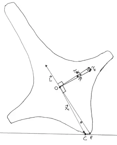

The diagram above shows a vertical cross section through the top, that contains the top's axis of symmetry. The point $P$ lies on the axis of symmetry, as does the top's center of mass $O$. The top's angular momentum $\vec{L}$ points in the direction of the axis of symmetry.
Because the top has a rounded bottom instead of a pointed bottom, the top's point of contact isn't at $P$, but rather at some point $C$. From the assumptions stated above, at the instant of interest $P$ is stationary. In contrast, from the direction of $\vec{L}$, at $C$ the surface of the top is moving towards the viewer, straight up out of the plane of the diagram. The sliding friction is a force $\vec{F}_k$ (not shown) on the top at $C$, in the direction opposite to the top's motion at that point, i.e., straight down away from the viewer.
The position vector of $C$ from $O$ is $\vec{X}_C$. The force $\vec{F}_k$ on the top produces a torque on the top around the top’s center of mass,
$$\vec{\tau} = \vec{X}_C \times \vec{F}_k \,\, .$$
The torque $\vec{\tau}$ can be written as
$$\vec{\tau}=\vec{\tau}_{\parallel}+\vec{\tau}_{\perp} \,\, ,$$
where $\vec{\tau}_{\parallel}$ is parallel to $\vec{L}$, and $\vec{\tau}_{\perp}$ is perpendicular to $\vec{L}$.
The torque $\vec{\tau}$ is how the top's angular momentum $\vec{L}$ changes with time,
$$\frac{d\vec{L}}{dt} = \vec{\tau}=\vec{\tau}_{\parallel}+\vec{\tau}_{\perp} \,\, .$$
$\vec{\tau}_{\parallel}$ points in the opposite direction as $\vec{L}$, so the effect of $\vec{\tau}_{\parallel}$ is to reduce the magnitude of $\vec{L}$, i.e., to slow the top down.
If the top was in empty space, the effect of $\vec{\tau}_{\perp}$ would be to rotate the top around $O$ clockwise in the diagram. However, due to the constraint that the top remains in contact with the table, the effect of $\vec{\tau}_{\perp}$ is instead to raise $O$ away from the table, and to make $O$ closer to being above $C$.

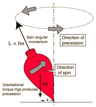

Consider an image bellow, A spinning top is rotating with an angular velocity $\omega$, Therefore it has an angular momentum $\vec{L}$, Faster it spins greater the $\vec{L}$ and more it tends to remain its rotational motion about a certain axis, Note that when it slows down (Due to frictional forces) it has smaller $\vec{L}$ Thus its precession increases due to its weight pulling it down. (A Gyroscopic effect demonstration video)
Source
Notice that Force of gravity caused our spinning top to precess (precess its axis of rotation) Thus we can conclude from this observation that a force must be applied to change spinning tops axis of rotation, Greater the force applied more it will precess from an original axis of rotation (assuming $\vec{L}$ is constant). When this force is removed it will naturally return to the original state with no precession because of it having angular momentum.

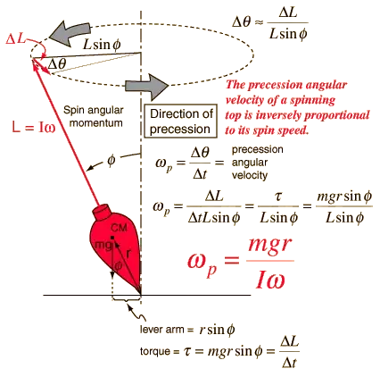

Note that torque is a vector and this vector is represented in the image bellow:
spinning top becomes almost upright again because it has angular momentum and that means that if an object spins it is resisting its axis of rotation to be precessed and faster it spins more it is resisting this precession to occur so if I tipped it over if it still spins with same angular velocity it will return to zero precession, faster it spins faster it will return to its original state.
To explain this mathematically consider a spinning top on earth with angular velocity $\omega$ its angular velocity of precession $\omega_p$ and angle of precession as $\phi$
its angular momentum is defined as:
$$\vec{L}= \vec{\omega} I$$
Say spinning top rotated $\Delta \theta$ and its change in angular momentum is $\Delta L$.
Then we can express $\Delta \theta$ as following:
$$\Delta \theta \approx \frac{\Delta L}{L sin(\phi)}$$
Angular velocity of precession can be expressed as following:
$$\omega_p = \frac{\Delta \theta}{\Delta t}$$
now we can substitute first equation in this one.
$$\omega_p = \frac{\Delta L}{\Delta t L sin(\phi)}$$
Torque is defined as change in angular momentum:
$$\frac{\Delta L}{\Delta t}= I \vec{\alpha} = \tau $$
Now we substitute this in previous equation:
$$\omega_p = \frac{\tau}{L sin(\phi)}$$
and we get the following formula:
$$\omega_p = \frac{\vec{F}r}{L sin(\phi)}$$
From this equation we can see that if we apply a force on a spinning object its $\omega_p$ will increase because it is directly proportional to force applied. If force applied is zero, $\omega_p$ becomes zero as well, therefore it will no longer have precessional angular velocity thus it will stand upright again.
