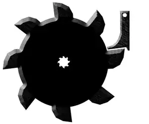

I think Ron's comment is very fitting and I want to add a simple fluid analogy.
Your AC source is indeed creating an oscillation in the position of the electrons over time. This has several advantages from an engineering standpoint as you can use generators, electric motors and transformers easily with an oscillating current.
The fluid analogy would be a pump that consists of a piston moving left and right which creates an oscillation in the movement of water molecules. Now you add a ratchet to this this circuit and you can use the oscillating water molecules to provide mechanical work.
