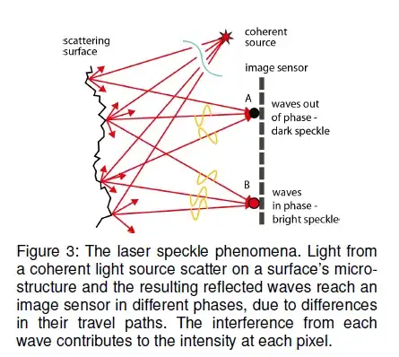

Objective speckle. The image below explains well how the speckle is formed: the light from each point on the illuminated surface adds constructively/destructively to form a single speckle. The phases in yellow help a lot in understanding how this happens.

  1. Different paths that light takes will cause different phases at a given point A at a screen. (That's geometry.)
  2. If there's no imaging system - the light hits an object, it gets scattered/reflected off the object, and meets at the screen. The waves interfere and form a speckle pattern depending on the roughness of the object. That's an objective speckle.
