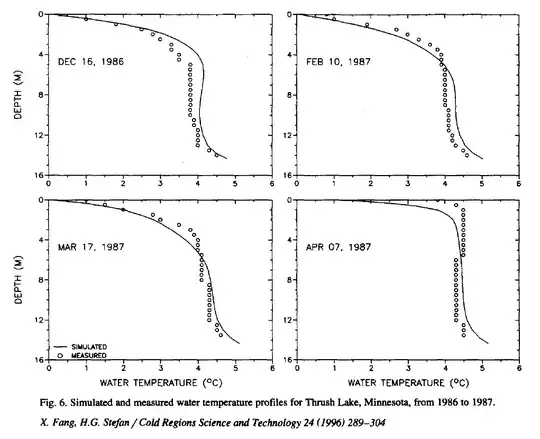

Simulated and measured water temperature profiles for Thrush Lake, Minnesota, from 1986 to 1987
If you look at this linked paper there is a measured temperature profile in a partly frozen lake on page 297 (reproduced above), and you can see the nearly straight line at slightly over 4 degrees, with significantly higher temperatures only at the very bottom. The warm water at the bottom will have a small advection forcing, heating up the higher layers.
The advection velocity will be very slow for these infinitesimal density differences, but the lake is very big, so even a small density difference leads to very slow average flows. This advection can only mix warm water from the bottom with the middle, and cold water from the top with the middle, keeping the middle at 4 degrees. The situation is extreme in the case of the Apr 1987 measurement in fig 4 of the linked paper, where nearly the entire lake is at a sharp 4 degree straight line, when the top layer of ice is nearly thawed.
