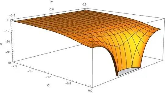

If you're curious, here's what the potential looks like as a function of $r_3$ and $w$, with $d = 1$: enter image description here

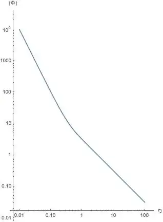

Note that the points $w = -1/2$ and $w = 1/2$ are the same point in space. We can also make a log-log plot of $|\Phi(r_3,0)|$ to examine how the potential behaves at both short and long distances: enter image description here
It can be pretty clearly seen that the slope of this graph goes from $-2$ when $r_3 \ll d = 1$ (corresponding to an $r^{-2}$ power law) to a slope of $-1$ when $r_3 \gg d = 1$ (corresponding to an $r^{-1}$ power law.)
