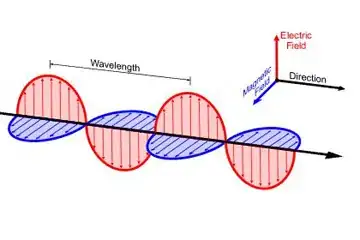

An electromagnetic field can be viewed as a combination of an electric and a magnetic field. See for example this youtube video for the classical representation of an EM field as a superposition of an electric and a magnetic field, or the following pictorial representation:
This happens because, due to Maxwell's equations, an oscillating electric field inevitably induces a magnetic field, and vice versa an oscillating magnetic field induces an electric field. More specifically, this is due to Ampère's and Maxwell-Faraday laws:
$$ \nabla \times \mathbf B = \mu_0 \left( \mathbf J + \epsilon_0 \frac{\partial \mathbf E}{\partial t} \right), \qquad \nabla \times \mathbf E = - \frac{\partial \mathbf B}{\partial t}, $$ which relate the rage of change of $\mathbf E$ and $\mathbf B$ to $\mathbf B$ and $\mathbf E$, respectively. A travelling electromagnetic wave is possible for this exact reason: an oscillating electric field will induce a change in the magnetic field, which will induce a change in the electric field and so on.
This means that yes, a moving magnet will emit electromagnetic radiation. You seem to only relate the words "magnetic field" to a magnetostatic field, which is what is produced by a (steady) magnet, and that indeed does not induce an electric field.
