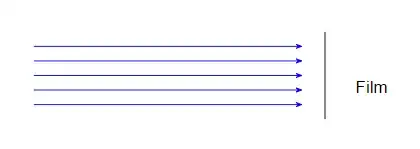

We'll assume the star/lamp is far enough away that the light rays coming from it are effectively parallel. start by replacing your eye with a sheet of photographic film, or a CCD or something similar.
Film
As you say, the light intensity will be constant over the whole area of the film.
