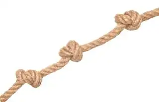

Suppose I have two identical ropes, one of which I manually tie some knots in. If I use them to hang clothes, which one is more durable?
knotted rope puppies on a line
Personally I think that rope with knots will be more durable, but I can't come up with a satisfactory reason.

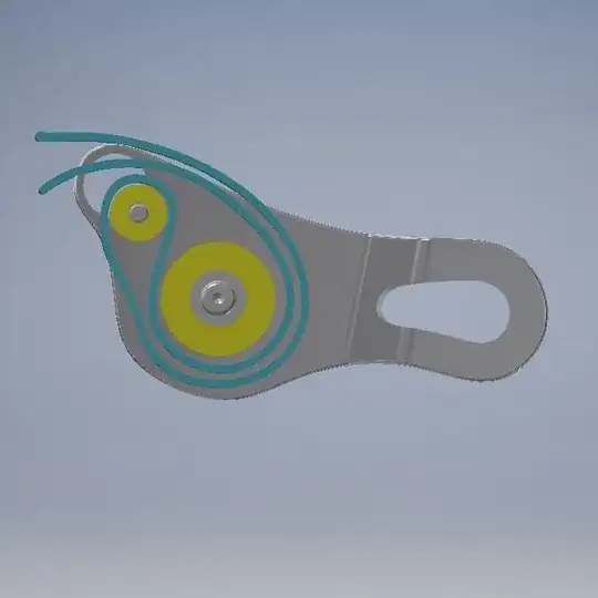

A curvature in the rope causes the tensile strength of a rope to decrease. The strongest configuration is the one where the stress distribution across the rope cross-section is close to uniform, i.e. when the rope is straight.
When the rope has a knot it may seem more stable, simply because the overall rope is thicker. However the rope will usually not break in the knot, but at the end of one, where there is a curvature.
If you are looking for data on the topic there are two main applications: industrial ropes and steel wires and slacklining. For the former knots are not very common (try tying one in a steel rope...), so I will briefly talk about the latter as an application of the concept.
One place where one has to tie a knot is the ends of a slackline. In fact there are special devices, called slackline weblocks that try to achieve that with minimal curvature (see picture).enter image description here
If you are searching for actual data on this the best place to search might be the Slackscience Blog by Balance Community. They have tests of different weblocks and how investigate how their structure effects the tensile strength.
