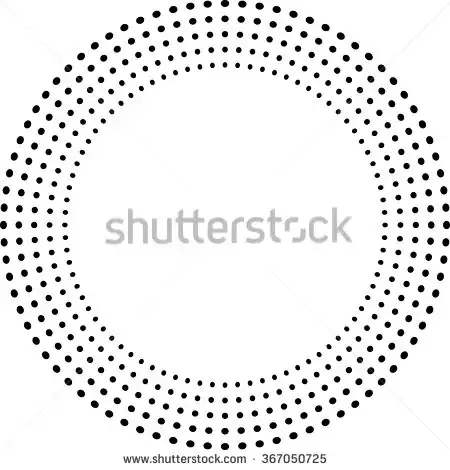

However, consider the following example:
This system is not a lattice, but nevertheless has a discrete rotational symmetry. In this case one can define a quasi-continuous analog of angular momentum, and the spectrum of the Goldstone mode corresponding to rotation symmetry breaking can be easily obtained.
This system also breaks translational symmetry. However, one cannot define a phonon mode that has linear dispersion as a function of momentum, although there does exist a Goldstone corresponding to translational symmetry breaking.
