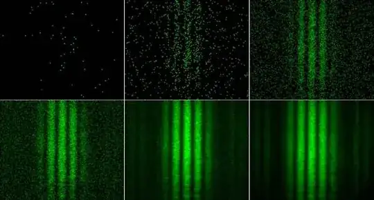

The wave that collapses, like all quantum mechanical waves, is the sinusoidal variation of the probability density (example of a probability density in QM) for finding a photon at (x,y,z,t) .The energy of the photon is fixed, in contrast to the electromagnetic light wave where the amplitude of E and B are "waving". The interference pattern in the single photon at a time is nature's calculation of this probability density for the given experiment .
singlephot
The single particle events pile up to yield the familiar smooth diffraction pattern of light waves as more and more frames are superposed (Recording by A. Weis, University of Fribourg).
Accumulation of photons in a single photon at a time double slit experiment.
