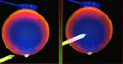

Evaporation of its "shell" would be the main source of the eventual POP. Air turbulence may distort it beyond the surface tension forces capacity to hold it together. If the air is very dry, even without touching anything, it will burst at some point.
Although this might surprise you, pushing through the bubble wall with a wet nail seems to work.
Image Credit: Popping Bubbles
