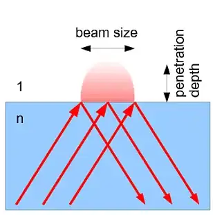

Consider a problem in classical electrodynamics, when a monochromatic beam experiences total internal refraction when traveling from a medium with $n>1$ to a medium with refractive index $1$ - see schematic below. Using Fresnel equations one gets the penetration depth $$d = \frac{1}{\sqrt{k_x^2+k_y^2-(\tfrac{2\pi}{\lambda})^2}},$$ where $k_x$ and $k_y$ are the perpendicular components of the wave vector, and $\lambda$ is the wavelength (in the vacuum).
At least in theory, it is possible to have an evanescent wave of an arbitrary penetration depth $d$. However, in such case one needs to use a plane wave, thus a wave of unbounded spatial size. For a beam with a finite variance $\langle x^2\rangle$ (and $k_y=0$ to reduce the problem to two dimensions) there seems to be a relation that $\langle d\rangle/\sqrt{\langle x^2\rangle}$ is lesser than a constant.
The main questions: is there any strict bound in the form of $$\text{a measure of penetration depth}\leq f(\text{transversal beam size},n)$$ (perhaps in the style of Heisenberg uncertainty principle, or using other moments of $x$, $y$ and $d$)?

There always is the Heisenberg principle, which, applied to a nearly unidirectional motion, states that $$\Delta x_T \Delta p_T \ge \frac\hbar2$$ for the transversal displacement and transversal component of momentum. Using the fact that for photons, momentum is directly proportional to wave vector through $p = \hbar k$, we can get rid of $\hbar$ and obtain a completely classical relation valid for beams, $$\Delta x_T \Delta k_T \ge \frac12.$$ Here $\Delta x_T$ is the square root of $\langle x^2 \rangle$.
Now let for total internal reflection, the light is incident at the boundary at an angle $\theta > \theta_{\it crit}$ to the normal. For the following, we will need the parallel component of the $k$ vector $$k_y = k \sin \theta$$ and its standard deviation $$\Delta k_y = \Delta k_T \cos \theta.$$
The mean penetration depth in the ensemble of the evanescent waves will still be expressed by the same formula, $$d = \frac1{\sqrt{k_y^2-\left(\frac{2\pi}{\lambda}\right)^2}},$$ but obtains a standard deviation $$\Delta d = \left| \frac{\partial d}{\partial k_y} \right| \Delta k_y = k_y \Delta k_y d^3 = \frac{\sin\theta\cos\theta}{\sqrt{(n\sin\theta)^2-1}^3}\left(\frac{\lambda}{2\pi}\right)^2 \Delta k_T.$$ One might rewrite this as an uncertainty relation multiplying by $\Delta x_T$: $$\Delta d \Delta x_T \ge \frac{k_y d^3 \cos\theta}2.$$
This deviation would actually enlarge the depth that the evanescent waves can reach. Indeed, the beam is composed of plane waves at angles slightly larger and slightly smaller than $\theta$. Those that reach $\theta_{\it crit}$ induce an evanescent wave of infinite penetration depth; those that have even smaller incident angle continue as plane waves in the other medium and reach infinite distances trivially.
