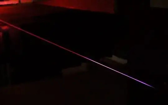

Here is an image of a laser-plasma filament (link to Laser Matter Interaction group at ENSTA ParisTech. Note that laser-plasma filaments are weakly ionized and often occur around the MPI and TI regimes. 1m laser-plasma filament in lab
I should comment that practically creating a room-length, fully ionized, plasma column would be difficult because the plasma will have a defocusing effect on the light. Filaments avoid defocusing issue by using self-focusing to offset the plasma defocusing but this is limited to weak ionization. Plasma defocusing might make it advantageous to go to shorter wavelengths
