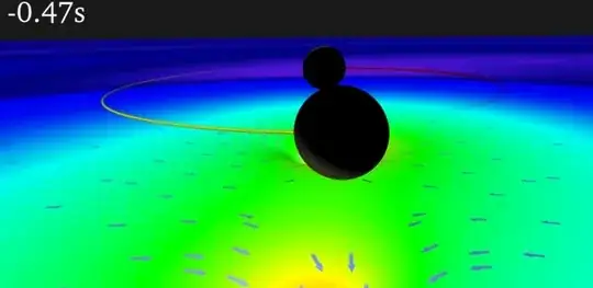

Image Source:LIGO Black Hole Merger
A video of the simulated merger of 2 black holes illustrated above

Even further, if the gravitational waves are being produced by the two bodies themselves (and if the orbit around each other they will produce them), they will loose energy to those waves and slow down some. It all depends on the strength and distances. In the two black holes that merged in 2015 and that Count_to_10 described in his answer, those waves were strong, and affected the motions of the two black holes before they merged. Those were calculated using numerical methods, the equations are not analytically solvable, and the effects were too strong to even use post-Newtonian approximations. The equations are non-linear, and with strong effects you cannot simply calculate motions ignoring the waves, then add the effect of the wave as there are nonlinear, and one has to find a consistent solution that accounts for all the sources of mass-energy that affect the curvature, and the gravitational waves are also sources (and interestingly, they are also part of the effects - thus nonlinearities enter in).
