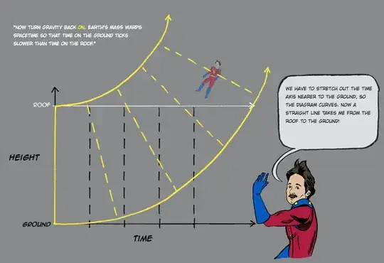

I found this demonstration which I find quite plausible, but I haven't found any references to it nor whether it is a correct (source is here: http://spark.sciencemag.org/generalrelativity/):
They explain gravitation via warping time part of the spacetime, however I find it a bit too simplified.
Is there some better demonstrations or some other relevant ones? Can you confirm the quality of the second demonstration?

The second diagram is a hundred percent correct.
One of the great principles of general relativity - the equivalence principle - can be used to reduce the diagram to one in special relativity.
We care about a person in freefall, jumping from the roof of a house and hitting the ground. The equivalence principle states that this is the same as someone standing in a spaceship which is accelerating at 9.81 meters per second squared. So we can consider an equivalent problem: The spaceship is accelerating at 9.81 meters per second squared, and passes a freefalling person, who "falls" from the nose of the spaceship to its tail. In the frame of the person (the free-falling observer), the spaceship (or ground) is accelerating towards him, and he is in flat spacetime! The equivalence principle states that "the ground rushing up to meet you" is a 100% accurate phrase. Let's work this problem out completely.

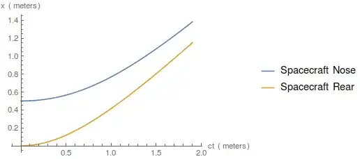

First we have to solve for what path the spaceship traces out. To make the units nice, I assume the rear of the spaceship is accelerating at $9\cdot 10^{16}\mbox{ meters per second}^2$ - a big number to compensate for the axes being "meters" in my graph. It turns out the $(ct,x)$ coordinates of the rear of the spaceship trace out the path $(\sinh(k),\cosh(k)-1)$ (measured in meters), and the front of the spaceship traces out the path $(ct_2,x_2)=((1+\ell)\sinh(k),(1+\ell)\cosh(k)-1)$, where $\ell$ is the proper length of the spaceship in meters. I plug in $\ell=0.5\mbox{ meters}$. This looks like the following:
accelerating spacecraft
Note that the coordinate position of the nose of the spacecraft slowly approaches the rear of the spacecraft due to length contraction.

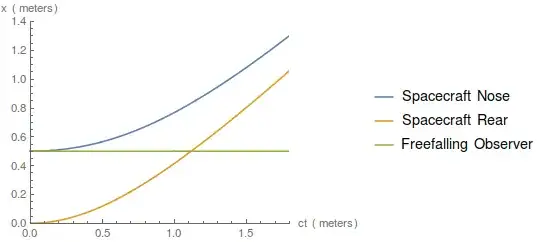

This is all described in flat, Minkowski spacetime. A freefalling observer feels none of the acceleration forces, and so simply moves in a straight line on this graph:
This is your original picture! Note that the reason the acceleration is so high on this graph is that one tick mark on the horizontal axis (the time axis) is only 3.3 nanoseconds! The real version, for our 9.81 meters per second squared, would just be a less exaggerated version of this graph.
Due to length contraction, the tip of the spacecraft is always moving a tiny bit slower than the rear of the spacecraft. Time dilation states that time ticks by more slowly for faster moving objects. Therefore, time ticks by on the tip of the spacecraft a tiny bit faster than on the rear of the spacecraft, according to our freefalling observer. This is exactly as stated in your example, where time ticks by faster on the roof than on the ground.
