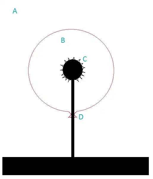

Edit 3: Thank you for all of the interest in this question. Due to some questions in comments I will provide some clarification details. After reading observations from count_to_10, Hames Large, and Marty Green regarding "hot" vs "cold" electrons, I see the experiment as the following diagram: enter image description here
A) The environment outside the balloon. This could either be air or a vacuum, so long as the entire experiment could fit inside a modern vacuum chamber.
B) The interior of the balloon (marked in red). As Ulthran pointed out this would essentially be a vacuum with possibly some electrons drifting around.
C) The top ball of a Van De Graff generator. Andrea Di Biagio pointed out that we have to be careful to not let all the charge accumulate in one spot. Normally the ball at the top would be flat, but here there are points attached to help the electrons discharge from the ball in a more or less uniform pattern. This design is from my limited knowledge of Van De Graff generators. Please feel free to suggest something else if there is a better way to move "cold" electrons into the balloon.
D) Here is the mouth of the balloon. This is somehow firmly attached to the pole of the Van De Graff generator with a highly insulating material. The goal is that the electrons will not move to the pole and air will not be able to enter the balloon and electrons will not be able to exit.
I think Andrea Di Biagio is the closest to a definite answer so far. The calculation arrived at about $N = 4.633*10^{13}$ electrons required to generate enough pressure (Thanks to Rotsor for some calculation adjustments). So the question is, can we fit this many electrons inside the balloon (turns out they all end up on the inside wall of the balloon), or will something happen to stop this, for example leaking through the balloon wall, dielectric breakdown, rubber chemical bonds breaking or something else?

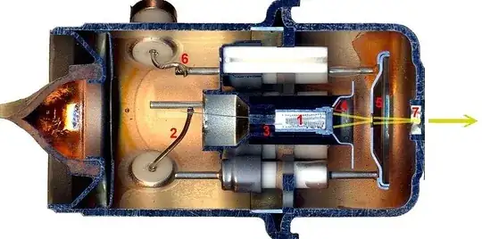

Image from Electron Gun Wikipedia
An electron gun, from an old TV set. The screen of these tvs incorporated lead-oxide glass since fast electrons are dangerous, and the k.e. of the electrons is probably high to easily burn through plastic. (Correction to original text thanks to James Large)
