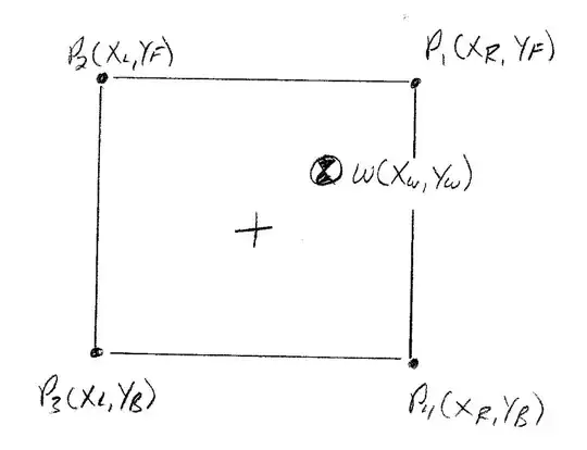

Assume you have a table with four legs with a weight placed somewhere inside the boundary created by the legs. The task is to determine the reaction force at each leg. Here are the problem constraints...
  1. The sum of the four reaction forces must equal the total weight set on the table.
  2. The table has no weight of its own.
  3. You cannot directly solve for the reaction of each leg using sum of forces and sum of moments because the structure is statically indeterminate.
  4. We are not allowed to introduce deflection in order to develop a 4th independent relationship between the four reactions
There are methods to estimate the reaction force on each leg. One such method uses ratios to determine the four leg reactions.
Square leg configuration \begin{eqnarray} P_1 & = & \left(\frac{y_w-y_b}{y_f-y_b}\right)\left(\frac{x_w-x_l}{x_r-x_l}\right) \\ P_2 & = & \left(\frac{y_w-y_b}{y_f-y_b}\right)\left(\frac{x_w-x_r}{x_l-x_r}\right) \\ P_3 & = & \left(\frac{y_w-y_f}{y_b-y_f}\right)\left(\frac{x_w-x_r}{x_l-x_r}\right) \\ P_4 & = & \left(\frac{y_w-y_f}{y_b-y_f}\right)\left(\frac{x_w-x_l}{x_r-x_l}\right) \end{eqnarray} Here is my question. The above solution is only good for a square leg configuration.

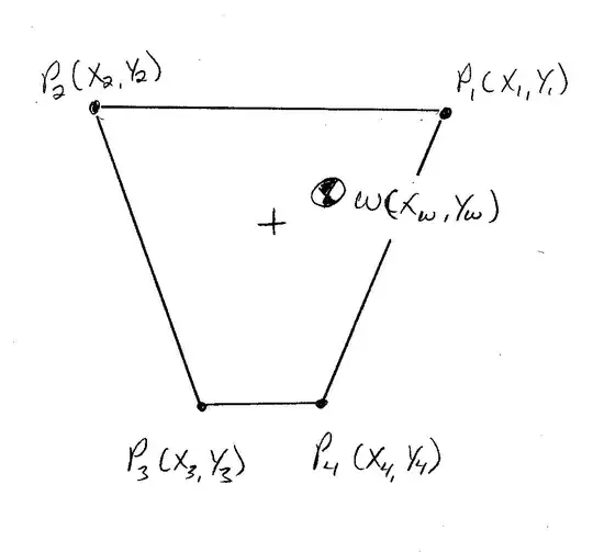

Can this method be modified to work for a trapezoidal leg configuration, like this? Trapezoidal leg configuration Better yet, can this method be modified to work for any leg configuration?
