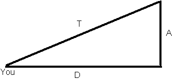

Suppose the diameter of the planet is $2A$. Suppose, at time $0$, that the light reaching you from the edge of the planet forms an angle $\theta$ with the light reaching you from the center of the planet. Set $X=Cos(\theta)$.
The light currently hitting your eye left the edge of the planet at some time $-T$ and has traveled a distance $T$ in the interim. So we have this picture, showing the distance to the edge and center of the planet at time $-T$:
This gives us two equations: $$D^2+A^2=T^2\qquad D/T=X$$ Solving, we get: $$D=AX/\sqrt{1+X^2}\qquad T=A/\sqrt{1+X^2}$$ Because the distance to the planet was $D$ at time $-T$, and because, in the interim, the planet has been traveling toward you at speed $v$, its current distance is $$D_0=D-Tv=A(X-v)/\sqrt{1+X^2} $$

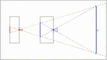

Here is a simple animation of how the velocity of the observer towards the object makes the light rays come in at a different angle so that the angular diameter appears reduced.
Note how a single photon appears to travel different paths according to the relative velocity of the observer.

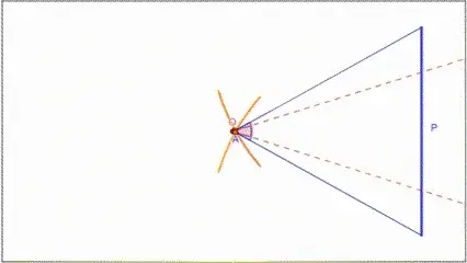

Below is animation made with a slightly more sophisticated interactive model which includes a simple model of a pin hole camera (or a very crude model of an eyeball).
The animation demonstrates that due to length contraction of the camera and due to the film plate at the back of the camera moving towards the point the photon entered the lens, the image produced is further reduced. demonstrates an additional reduction of the apparent optical angular diameter.
As soon as the ship accelerates, the angular diameter decreases due to relativistic aberration. This gives the slightly bizarre optical illusion that the target planet instantly appears to be further away, despite the calculated distance length contracting.
Question: does the distance as computed from the angular diameter (which is roughly the reciprocal of the angular diameter) decrease linearly during the pilot's journey?
Yes, once the rocket reaches constant velocity, the angular diameter increases in the normal way as the planet is approached.
When coming to a stop the angular diameter will suddenly increase giving the optical illusion of speeding up and getting closer to the planet, when in fact due to length contraction the distance you measure from planet has increased.
