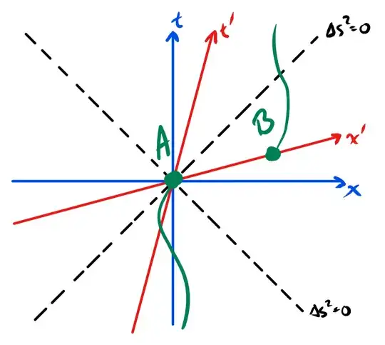

Let's be charitable and play along. Suppose you have an Alcubierre drive which successfully lets you travel at your speed limit, $v_\text{max} = 10c$, in some reference frame. Here's a spacetime diagram of your trip from my perspective. You're traveling on the green worldline from the past to the future. You turn the drive on at $A$, and off at $B$:
spacetime diagram
I measure that your speed between those two events, in $c=1$ units, is $$v = \Delta x/ \Delta t = v_\text{max},$$ while the coordinate-invariant interval between the two events is $$ \Delta s^2 = \Delta t^2 - \Delta x^2 = \Delta t^2 \times (1-v^2). $$ Along comes John Rennie from the left, traveling with the perfectly reasonable speed of $1/v_\text{max}$. John and I agree about spacetime intervals between events, but we disagree about time intervals and space intervals. In particular, John sees that the start and end of your trip, $A$ and $B$, are both on his $x'$ axis: those events happened simultaneously at different locations, so he sees your speed as infinite. (We'll ignore the other observers overtaking John from the left who see you exiting your Alcubierre craft, $B$, before you turned it on, $A$.)
This is kind of an interesting result. Suppose, as the Wikipedia article you link to does, that speed limit is somehow related to some measurable property of spacetime, like the Planck length. Since John and I disagree on what your actual speed is, we must also disagree on the parameter that explains it, based only on our perspective based on how we happen to be moving when we observe you. Any such parameter violates Lorentz symmetry; constraints on Lorentz symmetry breaking are quite tight.
