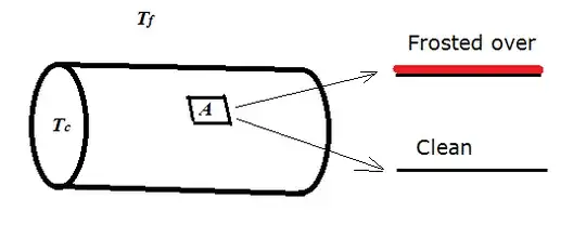

Cooling tube.
Cold fluid at $T_c$ runs through the cooling pipes. The cavity to be cooled is at $T_f$. Now let's look at small area $A$ on the surface of a cooling pipe.
When the cooling pipe is clean (not frosted over) then Newton's cooling law tells us that the heat flux (amount of heat removed per unit of time) $\dot{q}$ through $A$ is:
$$\dot{q}_\textrm{clean}=hA(T_f-T_c)$$
Where $h$ is the heat transfer coefficient.
But when the surface is frosted over with porous ice, then:
$$\dot{q}_\textrm{frosted}=uA(T_f-T_c)$$
It can be shown that:
$$\frac{1}{u}=\frac{1}{h}+\frac{\theta}{k}\implies u=\frac{hk}{k+h\theta}$$
Where $\theta$ is the thickness of the frosty material and $k$ the thermal conductivity of the frosty material.
Because the frosty material is a poor conductor of heat ($k$ has a low value):
$$h>\frac{hk}{k+h\theta}$$
(Note that the frosty material isn't pure ice, it's highly porous ice that contains much entrapped air, thereby further lowering the $k$ value of the frost). And this means that, all other things being equal:
$$\dot{q}_\textrm{clean}>\dot{q}_\textrm{frosted}$$
Multiply this of course for the total surface area of the cooling pipes. So clean cooling pipes carry away the heat more quickly, resulting in the compressor running for shorter times to reach the set temperature. This saves energy, Note also how freezers that have been frosted over more (higher frost thickness $\theta$) perform worse.

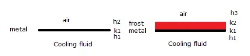

A slightly more detailed approach:
Composite heat transfers.
$$\dot{q}_\textrm{clean}=u_1A(T_f-T_c)$$ $$\dot{q}_\textrm{frosted}=u_2A(T_f-T_c)$$ Here it can be shown that:
$$\frac{1}{u_1}=\frac{1}{h_1}+\frac{\theta_1}{k_1}+\frac{1}{h_2}$$ And: $$\frac{1}{u_2}=\frac{1}{h_1}+\frac{\theta_1}{k_1}+\frac{\theta_2}{k_2}+\frac{1}{h_3}$$
But here too, because the frost conducts heat poorly ($k_2$ is small):
$$u_1>u_2$$
So that clean pipes carry off the heat more quickly, all other things being equal.
Symbols used in this section:
$h_1$: convection heat transfer coefficient, cooling fluid to metal.
$h_2$: convection heat transfer coefficient, metal to air.
$h_3$: convection heat transfer coefficient, frost to air.
$k_1$: thermal conductivity, metal.
$k_2$: thermal conductivity, frost.
$\theta_1$: thickness, metal.
$\theta_2$: thickness, frost.

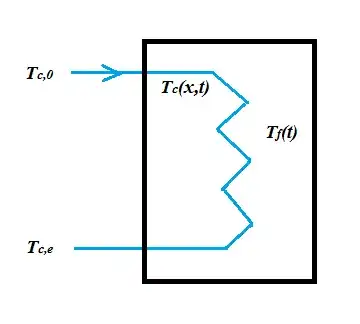

Another model:
Idealised refrigerator/freezer.
A coil or serpentine through which refrigerant fluid flows has a total length $x=L$. The cavity is perfectly insulated. The temperature $T_f(t)$ inside the cavity is considered time-dependent only (uniform spatial temperature distribution).
The temperature of the coil/serpentine is both time and position dependent: $T_c(x,t)$.
For an infinitesimal serpentine element $dx$ at $x$ an infinitesimal heat flux is given by: $$d\dot{q}=udA[T_f(t)-T_c(x,t)]=up[T_f(t)-T_c(x,t)]dx$$ Where $p$ is the perimeter of the pipe (e.g. $2\pi r$, in the case of a cylindrical pipe), so $dA=pdx$.
Heat absorption causes an infinitesimal temperature increase: $$dq=dmc_{p.c}dT_c(x,t)$$ And with $$\frac{dm}{dt}=\dot{m}$$ $$d\dot{q}=\dot{m}c_{p,c}dT_c(x,t)$$ Combining both expressions and integrating gives: $$T_c(x,t)=T_f(t)+[T_{c,0}-T_f(t)]e^{-\alpha x}$$ With: $$\alpha=\frac{up}{\dot{m}c_{p,c}}$$ For $x=L$: $$T_c(L,t)=T_f(t)+[T_{c,0}-T_f(t)]e^{-\alpha L}$$ Similarly: $$dq=-CdT_f(t)$$ $$\frac{dq}{dt}=-C\frac{dT_f(t)}{dt}$$ Where: $$C=\displaystyle \sum_1^nm_ic_{p,i}$$ We assume $t=0$ is the moment the pump is switched on and that the thermostat is set to reach a set temperature $T_s$ (the pump then switches off): $$T_c\leq T_s\leq T_f(0)$$ Using the expressions above some more can be derived:
1. Time $t_s$ needed to reach $T_s$: $$t_s=\frac{1}{1-e^{-\alpha L}}\frac{C}{\dot{m}c_{p,c}}\frac{T_{f,0}-T_s}{T_{c,0}-T_s}$$
This confirms the role of the heat transfer coefficient $u$, because as $u$ increases the factor $\frac{1}{1-e^{-\alpha L}}$ decreases. High values of $u$ thus reduce pumping time $t_s$.
2. Time-evolution of $T_f$: $$T_f(t)=\frac{\beta T_{c,0} t-T_{f,0}}{\beta t-1}$$ Where: $$\frac{1}{\beta}=\frac{1}{1-e^{-\alpha L}}\frac{C}{\dot{m}c_{p,c}}$$
3. End-temperature of coolant:
$$T_c(L,t_s)=T_s+[T_{c,0}-T_s]e^{-\alpha L}$$
Again the influence of $u$ is clear: higher $u$ lowers $T_c(L,t_s)$.
Notes:
I was hoping that a more detailed model would allow to address Hassassin's and Turion's concerns, regarding the 'second part of the cycle'. The argument goes that although pumping time is reduced, that says nothing about the energy needed to cool the eluted coolant back to $T_{c,0}$. This model doesn't really clear up that question.
This may in part due to the fact that refrigerators/freezers don't really operate the way described in this simple model. Instead a low boiling liquid is pumped through the serpentine and heat is carried off as latent heat of vapourisation of the coolant. The serpentine's temperature should therefore be roughly constant. Efficiency of of the refrigerator/freezer's heat engine may be the key to better understanding why clean appliances use less energy.
