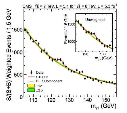

This is seen in the discovery of the Higgs at LHC:
higgs to gg
The black dots are the data. The green-red-dots line is what the Monte Carlo gave where the event generator has no signal of a resonance at 125. Once a signal is seen, the event generator is changed and a Monte Carlo data sample is generated to fit the observed signal at 125 GeV.
