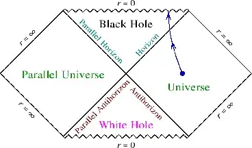

There is however a form of wormhole associated with black holes, called the Einstein-Rosen bridge. This is seen in the conformal diagram for the Schwarzschild black hole.
This diagram is an idealization and it may pertain to a pair of quantum entangled black holes. We may think of generating these black holes from EPR pairs of spins, and two sets of these are then brought together in separate regions to form the entangled black holes. The observer entering from this universe then can observe the world in this distant region, here called the parallel universe. The formation of a black hole may involve aspects of how elementary particles are entangled through the multiverse.
This is of course not traversable. There is no causal path that connects these two regions, or universes. So a black hole can't serve as a type of wormhole, such as in Joe Haldeman's novel “The Forever War,” where travel is facilitated by jumping through “collapsars.” The formation of the black hole is with states in entanglements $$ |\psi\rangle~=~\sum_ne^{-E_n\beta/2}|n_1\rangle\otimes|n_2\rangle $$ which in this Euclideanized form is boltzmann. The formation of the entangled black holes is from these entangled states. This is a standard case, and Hawking radiation produces particles in both universes, shifting entanglement from the black hole to these worlds. The Hawking radiation is blackbody in its statistics.
