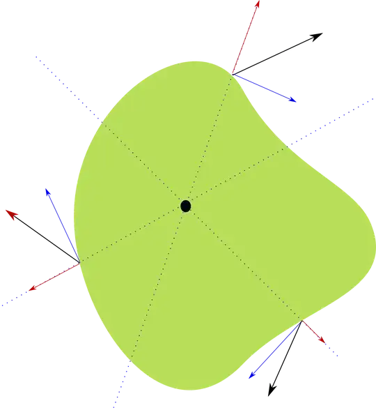

This is a simple problem and my intuition tells me that the rod will accelerate as if the two forces were to act on the center of mass, but what if it gets more complicated? what if the forces act on arbitrary locations relative to the center of mass of another rigid body, for example like this: enter image description here

A simple way to do this with force diagrams, is decomposing each force in two components: one component which accelerates linearly the body (along the line between the point where the force acts on the body and the center of mass of the body) and the other component that only produces torque (in the direction perpendicular to previous line).
Then the linear acceleration is related to the vector sum of the components in the lines to the center, and the total torque due to the sum of torques of produced by the tangential components.
