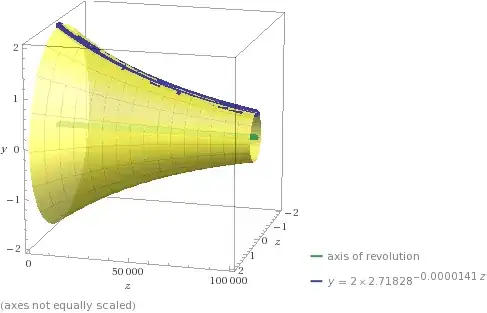

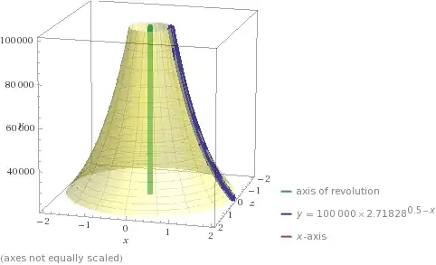

I tried to calculate Exponential cone like this Tower with 100 km height from carbon epoxy and factor of safety 3
which is Solid of revolution of this function
$$ f(x) = r e^{-α x} $$
where r is basement radius and α is kind of cone steepness. Volume can be calculated by formula from wikipedia article Solid of revolution Looks like for this exponential cone it is possible to build tower of any high from any material, but for materials with low compressive strength, if we take basement r=1 km, desired height 100 km for example, last 70% of the tower it will be very thick (like $10^{-5}$ meters). Of course this kind of needle is not possible to build and it does not make any sense to build. if we accept that final radius at maximum height 100 km equals 0.5 meter, the basement radius for different materials will be like this.

This is exact picture for tower with 100 km height from carbon epoxy and factor of safety 3 (all axes in meters)
Of course I do not consider wind, and all other things. With precise engineering calculation might be it will not be possible.
