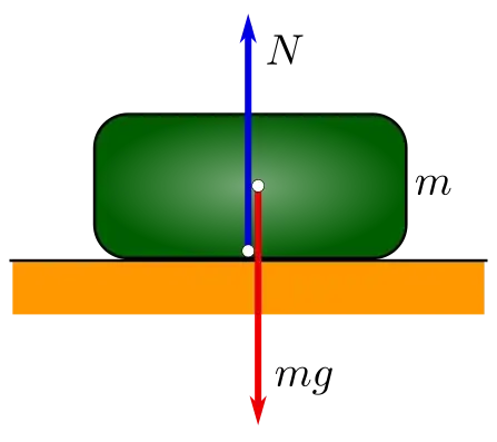

Here's the two most relevant forces for your question (source):
There are two forces there:
  • Gravity pulling down ($mg$, red arrow)
  • The ground pushing back ($N$, blue arrow)
For an object that isn't accelerating, $N + mg = 0$, or $N = mg$ (for simplification let's just say those are the only two forces acting on the object, that's all that really matters for this illustration). "Weight" is just one of those.
That's the key part.
