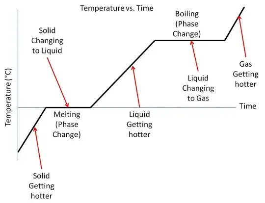

The bar has, depending on its composition, a specific temperature at which it will first become plastic, then a higher temperature at which it will eventually melt.
If you continue to put heat into the bar, by using say 100 similar candles, then, depending on the specific heat capacity of the metal, (that is the amount of heat needed to raise the temperature by 1 °C), the bar may melt, if enough heat is provided.
The specific heat capacity of solid aluminum (0.904 J/g/°C) is different than the specific heat capacity of solid iron (0.449 J/g/°C). This means that it would require almost twice as much heat to increase the temperature of a given mass of aluminum by 1°C compared to the amount of heat required to increase the temperature of the same mass of iron by 1°C.
This is a rough idea of how heat, increasing along the bottom line, raises temperature, and the horizontal lines are temperatures at which a phase change occurs.
Heat is a form of energy, when the bar heats up, and the candle burns out, the heat energy contained in the bar will be lost to the surrounding air, until everything in the system is at the same temperature.
There is one exception to this idea, called a phase transition. Say you continue to put heat into a solid bar, then just at the point where it goes to liquid form, you can put heat in, without raising the temperature.
The heat energy from the candles temporarily goes into breaking the chemical bonds that allow a solid to become liquid. After that the liquid metal will keep rising in temperature as long as you keep putting heat in.
