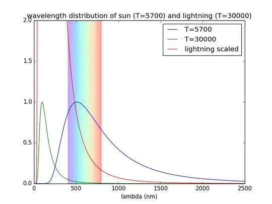

Also - remember that if an object is very bright, with just a small fraction of its emission in the visible spectrum, it will still "look" white (or blue-ish). As an illustration, here is a calculation of the spectrum for sunlight (5700 K) and lightning (very approximately 30,000 K - obviously the temperature changes during the strike, and from one strike to another; but most of the light is generated while it is hottest, with the usual $T^4$ relationship of the Stefan-Boltzmann Law dominating). I scaled the plot for lightning to a max of 1.0 for comparison of shape, and then scaled it so you can compare its shape against the shape of sunlight. In fact, the intensity at 30,000 K is MUCH brighter than sunlight - if I used the same scale factor for all curves you would not see much...
You can see that lightning (assuming a temperature of 30,000 K) gives off mostly "light" in the UV - but there is a component in the visible, which will be bluish - but which our eyes perceive as white.

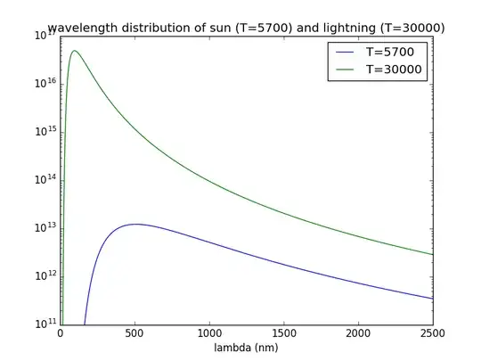

Putting the curves on the same log scale, you can see that the intensity is greater at the higher temperature for all wavelengths:

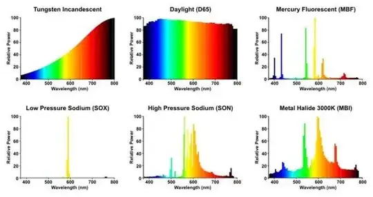

  1. At the pressure and temperature inside the lightning bolt (instantaneous heating to 30,000 K should raise the pressure locally to 100 bar), you will get significant spectral broadening - that is, Doppler broadening (atoms moving towards or away from the observer with equal probability, at velocity around 5000 m/s), and collision broadening (short time between collisions "resets" the natural oscillations - at high temperature and pressure, the characteristic time between collisions can become short enough to matter). These things play inside the high intensity discharge lamps used in demanding lighting applications (spectrum from http://www.lamptech.co.uk/Images/Illustrations/SO%20SPD's.jpg):
Such spectral broadening will help "whiten" the light some more.
