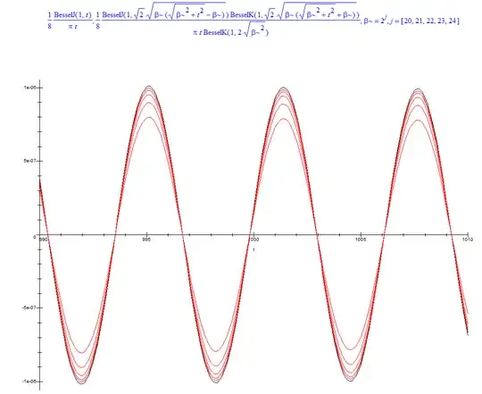

EDIT: To make this more concrete, the imaginary component of the mass $1$ propagator in real space at time-like separation is $I(t)=\frac{J_1(t)}{8\pi t}$. If we take a smooth unit weight mass distribution $$w_\beta(m)=\frac{\exp(-\frac{\beta}{m}-\beta m)}{2m^2K_1(2\beta)}\ \mathrm{for}\ m>0,\ \mathrm{zero\ for}\ m\le 0,$$ for large $\beta$ this weight function is concentrated near $m=1$, with maximum value $\sqrt{\frac{\beta}{\pi}}$. For this weight function, the imaginary component of the propagator in real space at time-like separation is (using Gradshteyn&Ryzhik 6.635.3) $$I_\beta(t)=\int\limits_0^\infty w_\beta(m)\frac{mJ_1(mt)}{8\pi t}\mathrm{d}m= \frac{J_1\left(\sqrt{2\beta(\sqrt{\beta^2+t^2}-\beta)}\right) K_1\left(\sqrt{2\beta(\sqrt{\beta^2+t^2}+\beta)}\right)}{8\pi tK_1(2\beta)}.$$ Asymptotically, this expression decreases faster than any polynomial for large $t$ (because the weight function is smooth), which is completely different from the asymptotic behavior of $I(t)$, $-\frac{\cos(t+\pi/4)}{4\sqrt{2\pi^3t^3}}$, however by choosing $\beta$ very large, we can ensure that $I_\beta(t)$ is close to $I(t)$ out to a large time-like separation that is approximately proportional to $\sqrt{\beta}$. Graphing $I(t)$ and $I_\beta(t)$ near $t=1000$, for example, and for $\beta=2^{20},2^{21},2^{22},2^{23},2^{24}$, we obtain Graph of $I(t)$ and $I_\beta(t)$ near $t=1000$ $I(t)$ and $I_\beta(t)$ are very closely in phase, as seen here, until $t$ is of the order of $\beta^{2/3}$ in wavelength units. We can take $\beta$ to be such that this approximation is very close out to billions of years (for which, taking an inverse mass of $10^{-15}m$, $\sqrt{\beta}\approx \frac{10^{25}m}{10^{-15}m}=10^{40}$), or to whatever distance is necessary not to be in conflict with experiment (perhaps more or less than $10^{40}$). This is of course quite finely tuned, however something on the order of the age of the universe would seem necessary for what is essentially a stability parameter, and the alternative is to take the remarkably idealized distribution-equivalent choice $\beta=\infty$ as usual. [I would like to be able to give the real component of the propagator at time-like and space-like separations for this weight function, however Gradshteyn&Ryzhik does not offer the necessary integrals, and nor does my version of Maple.]
