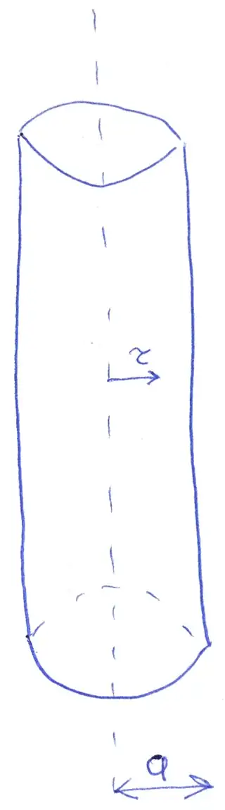

Assume a constant current flowing through a cylindrical conductor.
Applying Ampere's circuital law for a surface inside the cylinder:
$$\oint {\vec Bd\vec l = {\mu _0}\int\!\!\!\int {\vec J} d\vec s} $$ $$B2\pi r = {\mu _0}J{{\pi {r^2}} \over {\pi {a^2}}}$$ $$B = {{{\mu _0}} \over {2\pi {a^2}}}Jr$$
