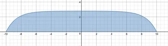

Also, the formula I've obtained for the shape of the drop is (in two dimensions): $$ H(r) = H_m(1-e^{\frac{tan{\theta_C}}{H_m}(\left|r \right| - R)}) $$ With $R$ the radius of the puddle, $\theta_C$ the contact angle and $H_m$ the maximum height of the puddle (can be obtained by the formula before) and the radius is approximately $R = \sqrt{\frac{V}{\pi H_m}} $. An example with R=10, the angle 64 degrees and the height 2.8.
