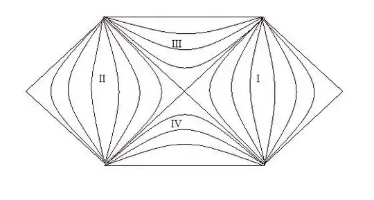

The change in the geometry is not entirely certain. One can appeal to exact solutions. With the Schwarzschild solution for a non-rotating black hole the conformal diagram
illustrates region I that is the exterior universe and region III for the black hole interior. The line separating them is the event horizon. There is another region II that is another exterior region, either another universe or some distant region in this universe. The two $45$ degree lines are event horizons and where they cross is where the black hole is a non-traversable wormhole connected by the event horizon. The horizon however splits and the two horizons separate at the speed of light. I illustrate this in the second diagram below enter image description here
There is a picture of a rocketship entering the wormhole. It can only traverse the bridge if it meets the horizon right at the vertex of this split. Without going into much complexity the problem with identifying this is that one would need a clock able to mark Planck units of time and this interacting with the black hole leads to further uncertainty. The region III expands, or spatial regions expand until the horizontal region at the top is reached. In this diagram this is seen by the expanding tube or bridge. This is the singularity, which is a spatial region where the curvature diverges. This rocketship in region III is unable to ever reach the region II. The singularity represents the collapse of this bridge that squeezes anything in there completely.

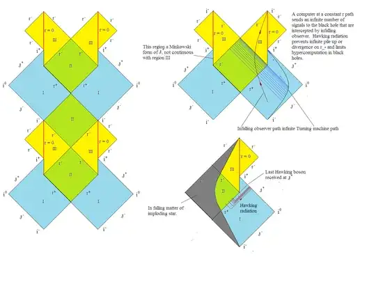

Let us now consider the case with electric charge, which is similar to including angular momentum. The Schwarzshild horizon occurs at $r~=~2GM/c^2$ for a black hole of mass $M$. For the Kerr-Newman solution there are two horizons that occur as $r_\pm~=~m~\pm~\sqrt{m^2~-~Q^2}$ for $m~=~GM/c^2$. This Kerr-Newman diagram is shown below enter image description here
I have changed this diagram a bit from the usual form to include Hawking radiation. This is not seen in the simple diagram for the Schwarzschild black hole. However, in that case the singularity is reached as a spatial surface for an interior observer corresponding to when the black hole finally evaporates. In this third diagram the one on the left is most important. There is the singularity $r_+$ that separates our region, say the blue region on the right, from the spacelike region interior to the black hole. However, $r_-$ the exists that leads to an additional timelike region with a timelike singularity. In addition the $r_-$ is reached by any observer at the moment all quanta that make up the black hole reaches it, and everything is blue shifted. This inner event horizon is then a Cauchy horizon, Cauchy in reference to his famous theory of accumulation points. Whether one survives this is a bit academic. Everything reaching this horizon is blue shifted arbitrarily, but so is any observer frame dragged across it. So this Cauchy horizon is a bit of a "soft singularity."
There is again this non-traversable wormhole as with the Schwarzschild case. The bridge expands, and in fact expands enormously, but is bounded by the maximal complexity permitted by this black hole, which is related to the entropy bound of the black hole and Hawking radiation. This then with the inner horizon. We might be tempted to treat $r_-$ as a singularity and deform the $r_-$ into spacelike regions with infinite curvature. This is if the Cauchy horizon is "not so soft" as a singularity. This is in part where the uncertainty in the geometry comes in. There also may be other quantum mechanical issues.
I illustrate something interesting about this in that an observer that registers qubits falling into the black hole can solve very complex algorithms. The piling up of these qubits is a asymptotic speed up of processing. If the black hole were eternal this observe could be a hyperTuring machine able to surmount the limits of Godel-Turing limits on computation. However, black holes are not eternal. However, this might have a bearing on NP-complete problems and their relationship is P-problems.
The Kerr-Newman black hole is much more of a "processing system" in terms of qubits. The inclusion of angular momentum or electric charge is definately a game changer. It also looks as if the same many be the case with gauge fields and quantum fields in general. This is particularly the case with the extremal black hole where $r_+~-~r_-~\rightarrow~0$.
