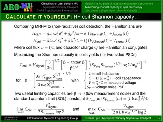

If we focus on magnetic resonance imaging and spectroscopy, and adopt Shannon channel capacity as a natural figure of merit, then it is straightforward to compute the quantum limits to this channel capacity (slide from a recent talk):
Shannon capacity associated to RF coil detection
(PDF file)
It is a remarkable fact that over the past 65 years, single-spin magnetic resonance channel capacity has doubled approximately once per year, and there is quantum head-room for approximately 27 more such capacity doublings.
Thus, if one is interested to press against quantum limits to speed and resolution in magnetic resonance imaging and spectroscopy, there is ample of work to be done, and plenty of scope for further improvements.
