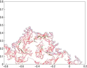

A remarkable 2006 Nature Physics paper by Bernard et al kicked off the little subject of finding SLE-like curves in turbulent systems -- here, the authors did a large numerical study of 2D incompressible Navier-Stokes in a turbulent regime, generating large data sets for the vorticity, and then plotted the zero-lines of this scalar field.
One sees curves such as this (red is the actual zero-line, blue is the "outer boundary", green dots are "necks of large fjords and peninsulas"):
figure 3 of Bernard et al
I'll just quote the key figure of the paper with some text from the paper here:

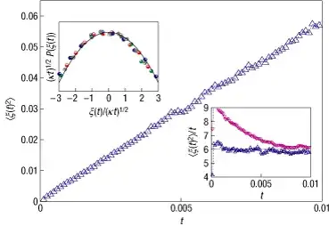

To determine which driving function $\xi(t)$ can generate such a curve, one needs to find the sequence of conformal maps $g_t(z)$ that map the half-plane H minus the curve into H itself. We approximate $g_t(z)$ by a composition of discrete, conformal slit maps that swallow one segment of the curve at a time (a slight variation of the techniques presented in http://www.math.washington.edu/~marshall/preprints/zipper.pdf). This results in a sequence of 'times' $t_i$ and driving values $\xi_i$ that approximate the true driving functions. If the zero-vorticity isolines in the half-plane are actually SLE traces, then the driving function should behave as an effective diffusion process at sufficiently large times. We have collected 1,607 putative traces. The data presented by blue triangles in Fig. 4 show that the ensemble average $\langle \xi(t)^2\rangle$ indeed grows linearly in time: the diffusion coefficient kappa is very close to the value 6, with an accuracy of 5% (see inset).

figure 4 of Bernard et al
Now mean squared displacement versus time is not necessarily the best test for the Loewner driving function to be Brownian motion (though in physics, this is basically all one sees), but still I think this plot is quite amazing.
