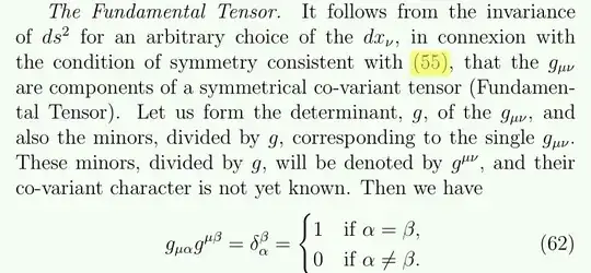

In Einstein's book- 'the meaning of relativity', he says- enter image description hereThe equation 55 mentioned is this one-enter image description here
I don't understand what the equation (62) means or how it can be proved. I know that the metric tensor is symmetric, but do not understand how equation (62) follows from it.
If $\alpha =\beta$, then we multiply every element in the matrix with its cofactor. If we carry out this procedure for 1 row and add the values, we get the determinant of the matrix, by definition. If we do it for all the rows, we get an integral multiple of the determinant as an answer. If we then divide the answer with the determinant of the matrix, we will not get unity, but an integer as an answer. So, how can $\alpha=\beta$ imply the sum is equal to 1?
Similarly, I do not understand how $\alpha \neq\beta$ implies the equation equals to 0. Please explain...

Eq 55 as shown is wrong (probably a typo). The "dx"'s should have upper indices.
Your analysis of eq. 62 is not really correct. But it is not really wrong either :-) It is just a misunderstanding of what Einstein meant and what it appears to mean to you.
Consider again eq. 62 $$g_{\beta\mu}g^{\mu\alpha} =\delta^\alpha_\beta$$
this equation just says that a matrix ($g_{\beta\mu}$) multiplied by its inverse $g^{\mu\alpha}$ is equal to the identity matrix ($\delta^\alpha_\beta$ is a tensor whose components form the identity matrix in any basis/coordinates). Note that the upper and lower $\mu$'s form a contraction, ie. a summation. So LHS is a matrix multiplication - summation/multiplication of rows (of $g^{\mu\alpha}$) and columns (of $g_{\beta\mu}$).
Now, when Einstein writes $\alpha=\beta$ , he means: take $\alpha$ and give it a numerical value, so that it represents a component (for example 1, the x component), then take $\beta$ and give it the same numerical value. You get $$g_{1\mu}g^{\mu1} =\delta^1_1=1$$ since $\delta^\alpha_\beta$ is a unit diagonal matrix. When Einstein writes $\alpha\neq\beta$ he means: give them different numerical values, say 1 and 0, and you get $$g_{1\mu}g^{\mu0} =\delta^0_1=0$$ which is 0 by the fact that it is an off diagonal element of the delta tensor. So this is the meaning of equation 62 which is correct.
You instead (probably) thought: $\alpha=\beta$ means "contract $\alpha$ with $\beta$" in which case you indeed get $$g_{\alpha\mu}g^{\mu\alpha} =\delta^\alpha_\alpha=4$$ a completely different result.
