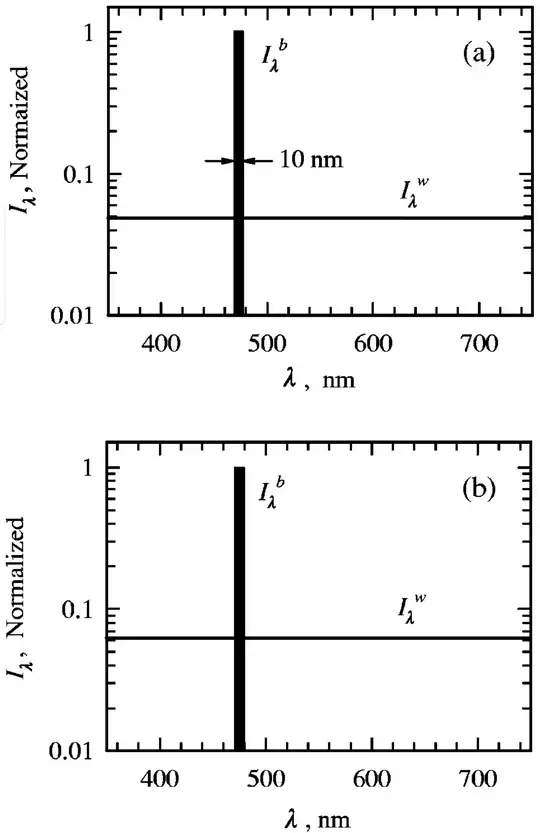

The article referenced above, by Glenn S. Smith, explains on page 594, with respect to available (Rayleigh scattered) light and the properties of human vision:
"The average observer sees daytime skylight as blue because the response of the eye to the spectrum of skylight is the same that to a mixture of monochromatic blue light (spectral blue light) and white light, that is, it is the same as the response to unsaturated blue light.".

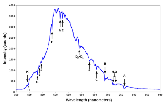

Figure 7.
"Fig. 7. Spectral irradiance for a mixture of white light and monochromatic blue light that is a metameric match to skylight. (a) Rayleigh sky ($\lambda^b$ = 474 nm), and (b) measured skylight ($\lambda^b$ = 476 nm).".

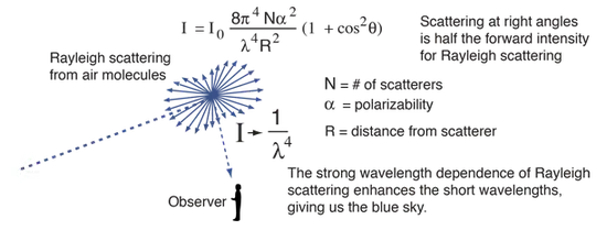

While Raman scattering plays a small role, the Rayleigh scattering (from the Hyperphysics webpage) is:
Rayleigh Scattering
You are certainly better off reading the more complete set of calculations offered by Smith.
