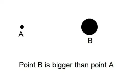

3.2. Assuming we must improve the physics, why should we change the definition of an undefined concept? (As far as I know, time is an undefined concept like point in geometry.) Why do we not change definitions those are defined by ourselves like velocity, kinetic energy, etc.? I think talking about time dilation is completely similar to talking about size of points on the plane. It is similar to that we say some points on the plane are bigger than the others! enter image description here Maybe it is true (maybe some points are bigger than the others in fact) but I think we cannot discover it because we don't know what point is (it is an undefined concept). As far as I remember, I have learnt that we have some undefined concepts and we define other concepts by getting help of them but we never can define them because if we could, they weren't called undefined. Can someone please define point for me? If he/she can, I will prove that there is no time dilation!
Note that this is not a definition for point: "A plane is created by points" because I will immediately ask "What is the plane?" And so on.
