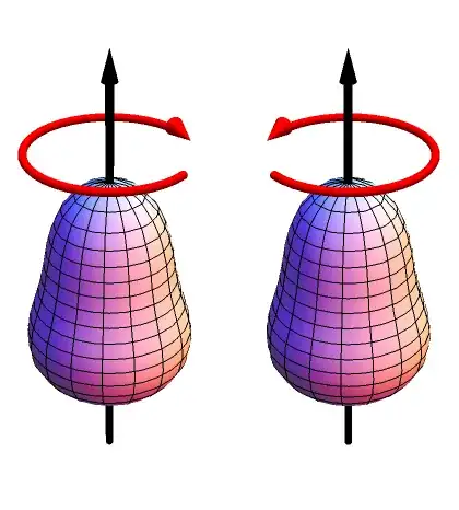

It is important to note that pear-shaped nuclei are indeed consistent with the Standard Model of particle physics. Pear-shaped nuclei are a bit of a problem because their shape has a direction, that is, you can draw a vector that starts at the flat end and points toward the pointy end (call this the pear vector $\vec P$). (The alternative, a rugby-ball-shaped nucleus, has an axis, but no preferred direction on this axis.) Because of symmetry considerations, this pear vector $\vec P$ needs to be on the same axis as the nucleus' spin $\vec S$, but these symmetries don't tell you which way they have to point, so you get two different versions of the same nucleus:
Mathematica code for this image through Import["http://goo.gl/NaH6rM"]["https://i.sstatic.net/HLcYp.png"], CC BY-SA with attribution to this page.
In a theory of nuclear physics that is mirror-symmetric, then both of these nuclei need to be completely equivalent (and, particularly, have the same energy), because they are mirror images of each other. What this paper finds (and what Gaffney et al. found in 2013) is that there are nuclei where this is not true, and these two nuclear states have different energies: the ground state is the "pear" state, and not the "anti-pear" one.
