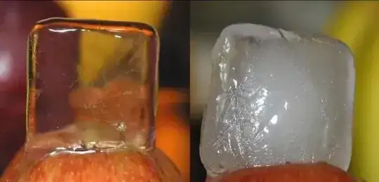

A common trick to make clear water ice is to boil pure water prior to freezing it. Why does that work and what are the white inclusions in ice that was made from unboiled tap water?

Note that this answer is incomplete: it does not answer why the gas dissolved in the liquid forms the bubbles it does when the liquid freezes, as in the right hand image of your question. This answer only explains the absence of the gas needed for the clouding process, so a full answer needs to explain why the dissolved gas comes out of solution to form bubbles as the ice freezes.

The short answer: Cloudy ice is caused by gases (mainly nitrogen and oxygen) dissolved in the water that come out of solution when the water freezes. The small bubbles trapped in the ice cause the white appearance. Boiling the water removes the air dissolved in it, producing clear ice as a result. Assuming that other impurities don't produce the same cloudy effect.

  • During freezing, the ice layer starts at all sides of the cube and grows inward. Water molecules fit the crystal lattice and will adhere to it, other molecules won't (but if the ice grows faster than the gas molecules can diffuse away, they will get trapped). The concentration of gases (and other impurities) in the remaining liquid rises, the solution becomes supersaturated, microbubbles start forming. All these get trapped in the ice, giving it a milky appearance.

The reason for the opaque center should be due to the manner in which the water volume is freezing. Presumably the solution is not mixed and the outside freezes first forming a crystalline (ice) wall through which the gas cannot escape. As the wall thickens gas is released from the water that solidifies into the central solution that remains. This concentrates the gas in the remaining liquid in the centre. When the gas concentration in this solution hits the saturation value for the liquid at it's current state some of it exits the solution forming the cavities, simultaneously some ice should form, returning the solution to the saturation concentration. This is repeated until all the water is frozen.
The observation that clear ice is made buy bubbling gas through it as it freezes, indicates that mixing of the solution allows the saturated gasses to escape from the surface of the total water volume as the solid forms rather then forming in the center.
Now one might ask the question why is it that there isn't just a single bubble. The first reason, from a bulk solution point of view, is that the water is freezing incrementally forming bubbles as it goes. It is really oscillating about the equilibrium state of the solution, that is the gas saturation point of the freezing solution. The exact conditions of this point will vary slightly as the liquid freezes. The pressure that the ice in the center froze at is likely larger then the pressure at which the surface ice froze at for instance, similarly there is a the temperature at which it froze might also vary. There is probably also a concentration effect, that is as this equilibrium point shifts about the gas saturation point will shift about, this change in concentration also affects the freezing point a little. There are about four effects (Temperature, Pressure, Volume and Gas Concentration) at play during the freezing. The second effect, from a finite volume point of view, is that locally about the cavity the water might experience a "rush of gas" which could locally freeze a film of water encapsulating the bubble hence the final complex arrangement of cavities and not the formation of a single bubble.
