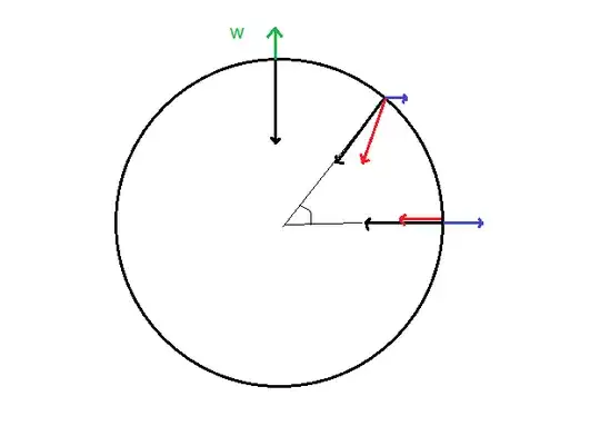

Just to expand a little bit... The centrifugal force on a particle of mass $m$ is given by $$\vec F_{ce}=-m\vec\omega\times(\vec\omega\times\vec r),$$ where $\vec\omega$ is the Earth's angular acceleration and $\vec r$ is the position of the particle. This force must be taken into account when using Newton's second law in the non inertial frame. Similarly to gravitational force, this term depend on the mass of the particle so it is useful to combine it with the weight $m\vec g$: $$\vec F=m\vec g-m\vec\omega\times(\vec\omega\times\vec r)=m\vec g_{eff},$$ where $$\vec g_{eff}\equiv \vec g-\vec\omega\times(\vec\omega\times\vec r)$$
This is the the acceleration feld by the particle. If the origin of the non inertial system is at the center of the Earth you can easily check that the vector $-\vec\omega\times(\vec\omega\times\vec r)$ is always pointing as in the white arrows below. The gravity $\vec g$ points radially inwards as the black arrows. Then the effective gravity $\vec g_{eff}$ points as in the red arrows. As you can see, for any place on Earth except over the poles and the equator line, $\vec g_{eff}$ will always have a tangential component (in a tangential plane). enter image description here
