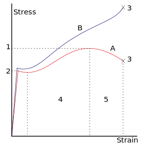

Technically WikiPedia is correct but we usually use apparent stress during stress strain curve (Mostly) and not actual stress . Apparent stress(or engineering stress) is the one you mentioned and the one mentioned by Wikipedia is actual strees(or true stress)enter image description here
As you can see in this picture A is engineering stress strain curve whereas b is true stress strain curve.
