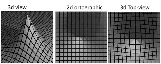

Let's take an analog on 2 dimensions:3d view of a 2d curved space
The distortion on space is visible only by a 3d being (such as a human.) The 2d creatures can't see the distortion, as they are 2d creatures, but they can see that space is 'bigger' where the distortion occurred, because the total area of the squares (as viewed from the top--i.e., from a different coordinate in a third, orthogonal dimension--increases.
In the real world, the axis of distortion is trickier to define. The space needs to be expressed as cubes, not squares, and what changes with distortion is the volume of those cubes.
So, if you have two identical boxes, one with a very massive object, and another empty, the one with the massive object fits more things inside it?
