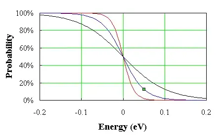

That definition of the Fermi level is applicable to all materials. However, I believe you'll find it a lot clearer once you understand that the Fermi level is in fact the energy level at which the probability of an electron state being occupied is 50%.
In a semiconductor, the Fermi level is indeed in the forbidden band, however there are no available states in the forbidden band. Therefore, even though the probability of an electron state being occupied is 50%, there are no electrons present in the bandgap (0.5*0=0).
It is very incorrect to say that 50% of the electrons have energy above the Fermi level. While it is certainly possible if you have an incredibly skewed distribution of electron states, this is not true for most materials.
The area under the graph before the Fermi level is clearly much larger than the area after it.
