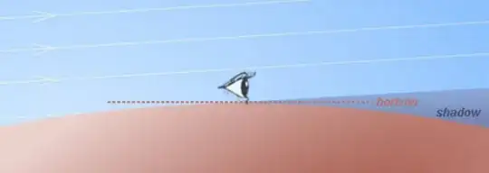

Seen from their summits almost all mountain shadows look triangular regardless of the mountain's shape. This is a perspective effect. You are standing at the top edge of a long tunnel of shadowed air and looking along its length. The tunnel's cross section is the shape of the mountain but its "end" is so far away that it looks insignificant. The finite size of the sun also causes the umbral (fully shaded) parts of the shadow to converge and eventually taper away. The tapering sets limits to the umbral length of shadows. That of the Earth is over a million miles. That of a high mountain can be two to three hundred miles. Triangular shadows are not seen from objects much smaller than mountains because their shadows are not long enough.
On another page, it says:
Mountain shadows at sunrise and sunset are immensely long tunnels of unlit air, crepuscular rays in fact.
From the summit, perspective effects nearly always make the shadow triangular regardless of the mountain's profile. You are standing at the top edge of the shadowed tunnel and looking out along its length which can be more than a hundred miles. Only the shadow's end carries much information about the mountain shape and it is so far away and in any event blurred by the 0.5ยบ angular spread of the sun's rays that it is hardly visible

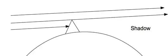

I include a (totally professional) sketch illustrating the phenomenon:
