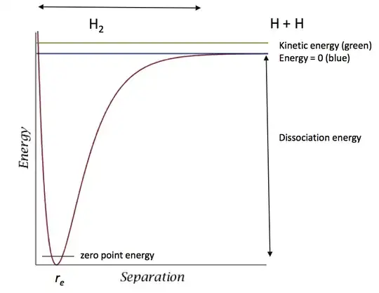

The figure shows a one dimensional cut through the spherically symmetric potential energy surface, which is appropriate as we deal with atoms. (If an atom reacts with a diatomic then a 2D contour plot is needed). The energy profile is shown in the diagram.
PES diatomic
The initial kinetic energy is the energy of the green line above zero which we take as the energy of the two atoms when distant from one another. As the atoms approach the red line shows the potential energy which increases (in the negative sense) as the molecule forms and the potential is attractive to larger separations that $r_e$ the equilibrium internuclear separation and repulsive at shorter separation. Only the zero-point vibrational energy level is shown.
The kinetic energy rises as the potential energy falls, as total energy is constant, and mirrors the potential energy. When the inner repulsive energy is reached then the two atoms now start to move apart. The time for this approach and separation across the potential well, is approximately half a vibrational period, so typically a few femtoseconds up to about $0.1$ picosecond at most) depending on the atoms ($1\,\rm fs = 10^{-15}\, s$). This is shown by the top horizontal arrow. Not much can happen in this time. The $\mathrm{H_2}$ cannot radiates if it is in its ground electronic state because of radiation selection rules, but $\mathrm{HI}$ could do this and emit an infra-red photon. However, the chance of this happening is vanishingly small as the radiative lifetime in the infra-red is vast compared to the vibrational period. (If the kinetic energy is so large that excited states are produced fluorescence may occur, but again the chance is very small for the same reason.)
