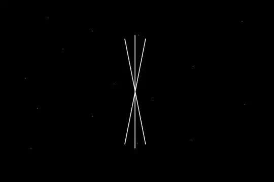

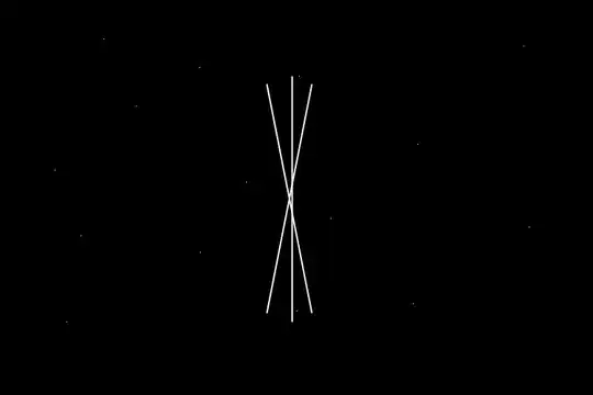

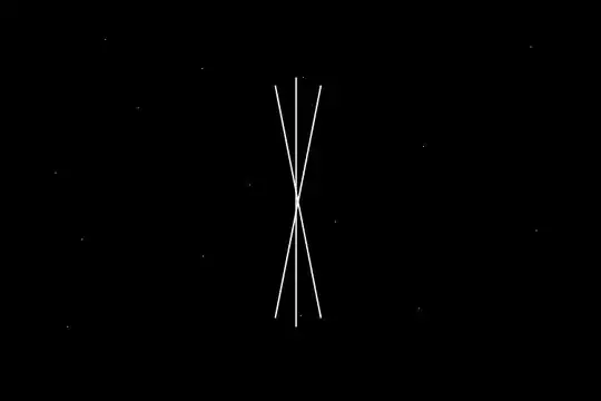

I'm not sure about any particularly great scientific articles that will help you understand. Wikipedia has a basic article on Bhatinov masks. However, I hope the following diagrams demonstrate the concept well enough. The general idea of a Bahtinov mask is that it creates a specific layered diffraction pattern. The three patterns overlay each other in a specific manner such that when they line up, it is obvious. The patterns form a central "pole" and an "X". When the pole runs through the center of the X, you're properly focused. If the pole is shifted to one side or the other, you're not in proper focus. The examples below are a bit basic and exaggerated, but hopefully they demonstrate well enough.
Focused enter image description here
Out of Focus Left enter image description here
Out of Focus Right enter image description here
