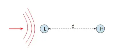

The time delay depends on the direction the wave is travelling. If it is travelling along the line connecting Livingston and Hanford then the delay time would indeed be the Livingston-Hanford distance divided by $c$:
Parallel wave
However suppose the wave was travelling normal to the line connecting the two detectors. In that case the wave would arrive at both of them at exactly the same time and the delay would have been zero:
Perpendicular wave
So the delay can be anything from zero up to $d/c$ depending on the direction the wave is travelling. The only real upset would be if the delay was greater than $d/c$ as that would mean the wave was travelling slower than light.
