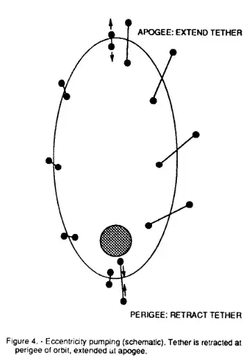

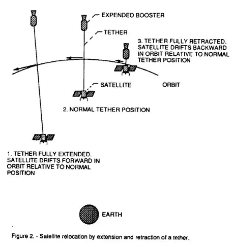

Thanks to Michael Seifert's answer, I found a paper he referenced: Satellite Relocation by Tether Deployment by G. A. Landis and F. J. Hrach, 1989.
By extending a tether radially, a satellite can increase or decrease its orbital speed (pictures below copied from the paper):
Figure2. - Satellite relocation by extension and retracton of a tether.
The principle then can be used to pump an eccentric orbit:
Figure 4. - Eccentricity pumping (schematic).
Similarly a planet like Solaris could then assume an elliptical shape, prolonging itself in a radial direction, to change its trajectory.
