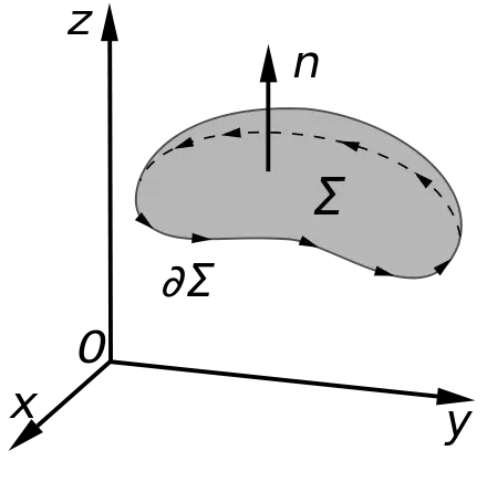

For an open orientable surface there are two possible, equivalent normals: $\vec n$ and $-\vec n$.
The usual convention is that you choose a direction in which the perimeter of the surface is traversed and define the positive direction as the direction given by the right hand rule, as shown in the following picture.
