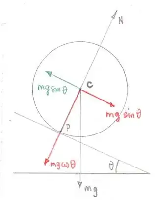

The apparent paradox is resolved by realising that using a frame of reference relative to the sphere which is accelerating down the slope is a non-inertial frame of reference.
If there is friction and the no slipping condition is satisfied then the frame of reference attached to the point of contact $P$ is an inertial frame because momentarily the sphere at that point of contact is not moving relative to the Earth which is assumed in such examples to be a good approximation to an inertial frame.
When there is no friction the point of contact on the sphere $P$ is accelerating relative to the Earth and so a pseudo force $mg \sin \theta$ up the slope (green) and passing through the centre of mass of the sphere $C$ has to be introduced if Newton's laws are to be used in that non-inertial frame.
Remember that when you sit in that frame of reference the sphere is stationary relative to you and so the net force and torque on the sphere as you see it must be zero.
So with the introduction of pseudo force, the net force and the net torque acting on the sphere are zero.
If you take a stationary point $P$ on the slope as defining your frame of reference then there is a torque about $P$ on the sphere due to the component of the weight down the slope $mg \sin \theta$ and that torque causes the centre of mass of the sphere $C$ to have an angular acceleration about point $P$.

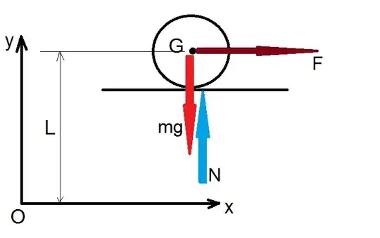

Consider to figure below (there is no friction):
If we calculate the net torque about point $\textrm O$, we will have: $$\Sigma M_{\textrm O}=-FL$$ Can we say that the block will rotate about point $\textrm O$? Yes, we can. But, this rotating isn't equal to rolling. This rotation is a particle rotation about a point. Because particles of the sphere don't move relative to each other. They move simultaneously on parallel paths. When we say sphere is rolling, we mean that sphere is rotating as a rigid body not a particle.
Equations of motion in plane for a rigid body are expressed below: $$\Sigma \vec F=m\vec a_{\textrm G}$$ $$\Sigma M_{\textrm G}=I_{\textrm G}\alpha$$ $\textrm G$ is the center of the mass.
So, for a rigid body, the necessary condition for rotating is $\Sigma M_{\textrm G}\neq 0$
P.S. Thanks to @garyp for reminding:-)
