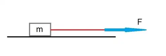

In a theory view point, it is possible. For example, consider figure below. The string is massless and inelastic (rigid). (There is no friction)

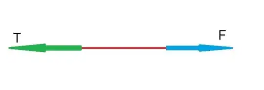

The string moves with the mass $m$, so its acceleration is $a=\large{\frac Fm}$. But, the net force acting on the string is zero.
$$\Sigma F_{\text{string}}=F-T=0$$

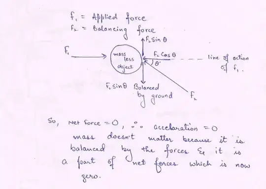

No Bro. *even though the object is mass-less and the net force is zero but also then it can't accelerate. net force can be zero only if any force(s) is balancing the applied forces i.e. the resultant force will have no direction so there is no reason and direction left for the object to accelerate for.In the figure the ground can be ground or any kind of support.that's just an example. *enter image description here
**hope you decipher what i am trying to explain to you.Looking for your further suggestions. Even if there is any flaw in my explanation inform me please so that i can make my concepts clear.
